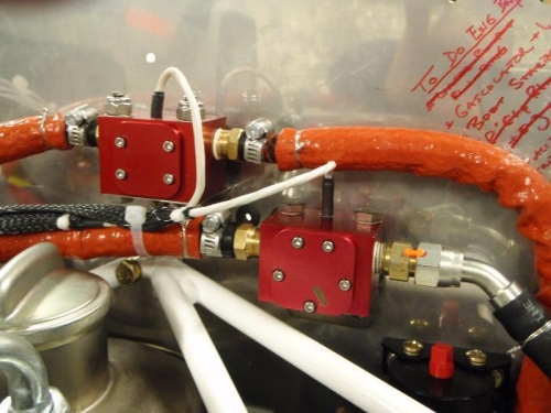

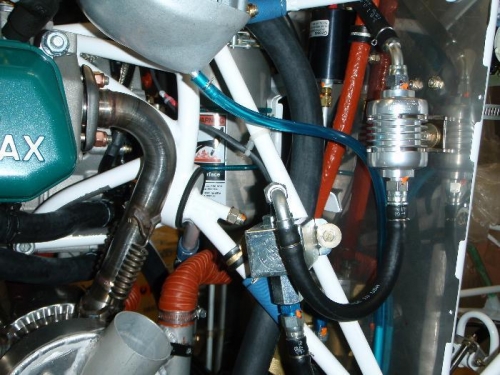

Brief Description:  Installation of fuel gascolator,fuel filter,four w
Mount fuel pump assy.Fuel gascolator supplied with kit replaced with a Steves Aircraft of,Oregon Part number SA3-00-B,this is a better quality unit features a saftey pin and 1/3 turn action to remove bowl,mounting bracket and backing plate manufactured.Fuel filter replaced after Rans Alert bulletin,Aircraft Spruce Pt number 05-01699 installed,10 micron rating and featues cleanable sintered metal element.Electronics International Fuel flow system installed,mounting brackets built,gauge fitted,matching box fitted and flow transducers/return and supply/ Four way distributer block manufactured and mounting bracket contructed,fitted to ballance tube with Adel clips.Make up all fuel lines and heat sleeving.
