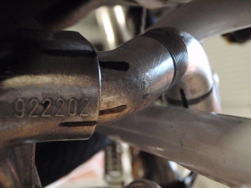

After much frustration of trying to instal the L/H and R/H upper water pump housing to cylinder water fittings and not being able to obtain any clearance of the rubber hoses thru the engine mount even after repositioning the two alloy elbow fittings,I have decided to try a modification in extending the allow pipes out thru the engine mount as you can see this is just in the mock up stage at the moment as I intend to get some welding done on the fittings......stay tuned.Looks quite an improvement at the moment...fingers crossed
R/H side note moded tube

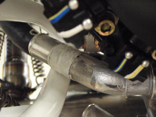

L/H side of water pump still working on angles

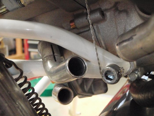

R/H side lots of clearance if this works...
