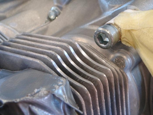

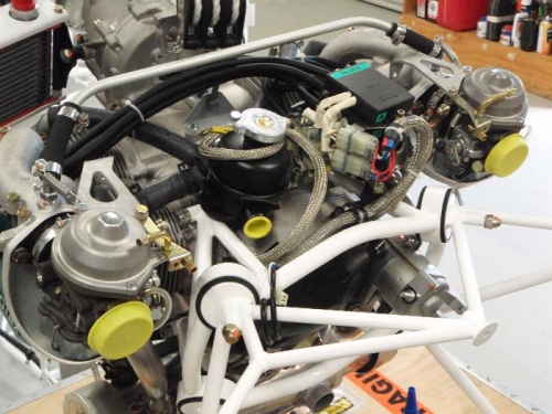

Build up fwd and aft engine mounts,modify rear L/H cylinder cooling fins to allow insertion of engine mount bolt,swap both induction manifolds and carburettors,install new ballance tube,rotate starter motor attach clamp,installoil pressure s/w,drill 4 x engine mount to engine bolts and install engine mount assy to engine..torque all hardware and saftey wire
modified aft L/H cylinders cooling fins
engine mounted on mount and induction manifolds

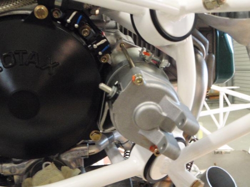

engine starter motor attach clamp repositioned
