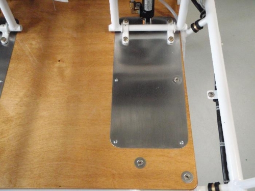

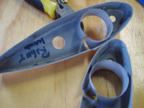

Miscillaneous jobs,pressure transducer replaced with VDO 0-10 Bar unit to suit new oil pressure gauge.Stainless steel hardware installed on floor area and fairing supports beefed up with aluminium backing plates to receive rivets

Stainless steel hardware and tinnermans fitted
Aluminium backing plates prosealed to inner sufface of supports to receive rivets
