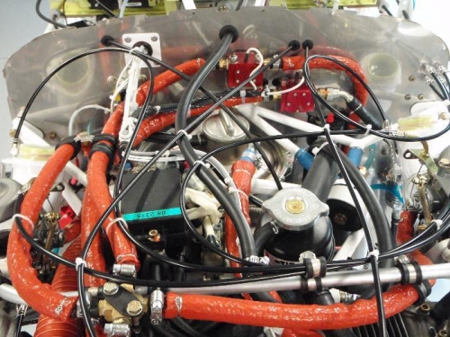

Brief Description:  Air diverters ,control cables,

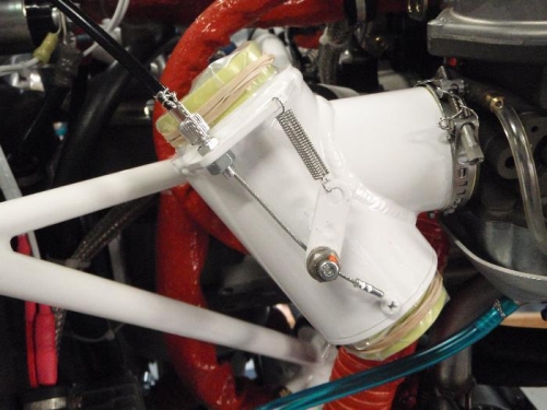

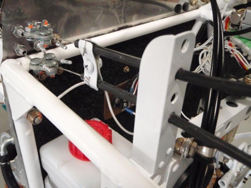

Paint both air diverters and install on engine,drill off dash and install control cables,cabin air,carby heat,park brake and choke,install all cable outer sheaths and route toassociated components.clamp all cabling and cut and install inner cabling.Rig choke,carby heat and park brake.**One problem encountered when running cables through the firewall was that the furnished holes fro the cabling clashed with the fittment of the engine air filter.Four cable hole locations moved outboard to the left to clear air filter
Air diverters installed and rigged
All control cabling secured
Choke and carby heat **Note extra calble supports
