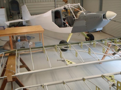

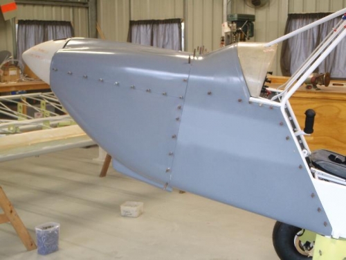

Today we fitted the bottom cowl to the previously fitted top cowl.All pretty straight forward most of the joggled edges had to be dressed square with a file and the front of the cowl around the air inlets will need some work with a little glass and epoxy filler to true up the two halves.next job will be to tidy up all the seams and install fasteners
Major fittment complete
Starting to take shape

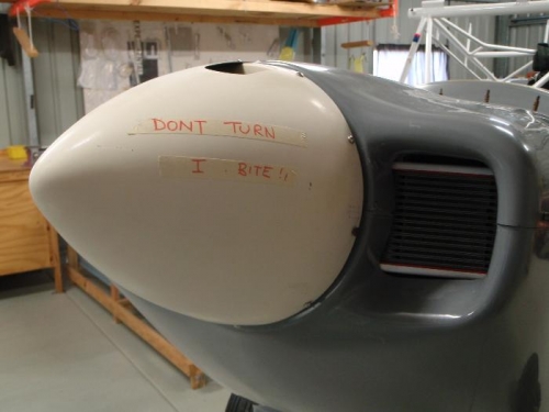

Fairing and contouring to be done around the air inlets
