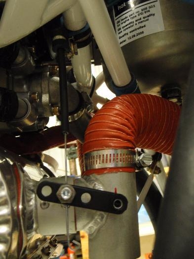

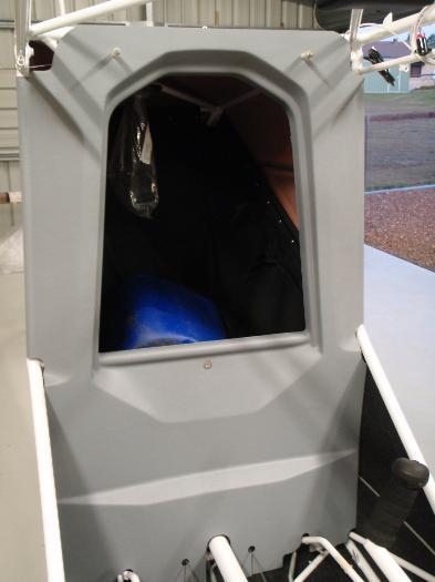

Final fittment of aileron pulleys/ Fit,cut and trim baggage compartment plastic close out panel,modify and install extra central fastener (anchor nut and clip,mid way across lower edge of opening),Cut cabin heat cable to length and adel clip to engine mount,fit cable terminating ferrel and rig system.............Clean up shop....
Completed close out fairing
Cabin heat rigged
Cabin heat rigged

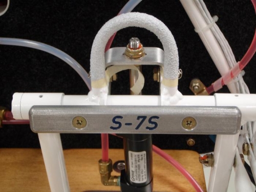

Engraved pedals
Engraved pedals
