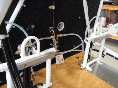

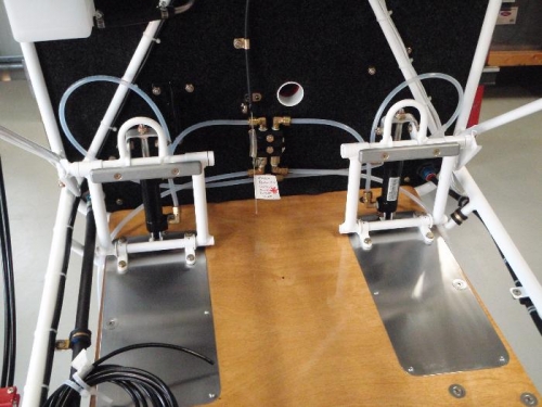

Brief Description:  Installation brake plumbing and park brake cable
Install all compression fittings in park brake valve,brake cylinders and brake pucks.Size up and install all plastic brake lines from park brake down to brake calipers and clamp as required.All brake lines out side cockpit area run through clear plastic tubing to prevent chaffing in fairing area.System yet to be filled with fluid and bled
Nylon brake lines fabricated
Park brake control cable installed and pre rigged,final rigging once brakes are bled
