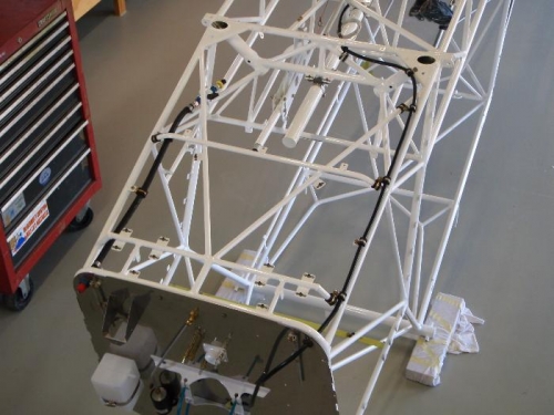

Brief Description:  Flap mechanism,wiring,fuel line
All painted components assembled,I manufactured a 7/16" aluminium spacer to lift lower mount to obtain clearance 1/ for handle to seat tube clearance and 2/clearance for the rod ends attached to lower end of handle.
Adel clamped main fuel line and main battery wire
Completed flap mechanism
Lower mount spaced up 7/16
Lower mount spaced up 7/16" to obtain clearance between handle and seat tube
Fwd fuel line,shut off valve and clamped battery wire
