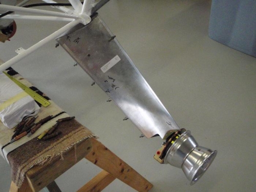

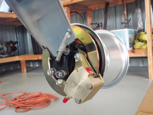

Brief Description:  Main gear fairings,hubs and brakes..prefit..
Prepare and trim plastic former for inside fairing,pre trim fairing,fit fairing to gear legand drill off rear seam,install brake caliper,hub and aluminium lower fairing clip.Drill off lower clipand install all clecos..Note bolts shown in photo two are only dummy assembly bolts and nuts...Photo three Tundra tire option...All metal work to be removed now for clean up,debur and painting
fairing fitted
fairing fitted
Matco wheel and brake assembly
