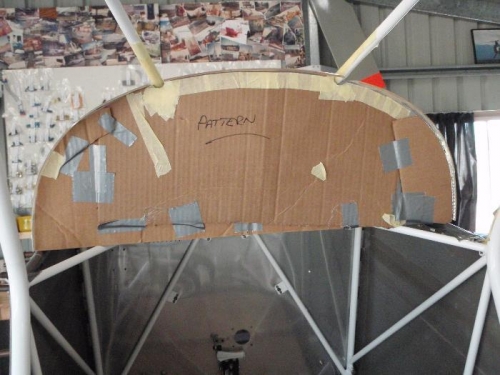

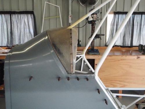

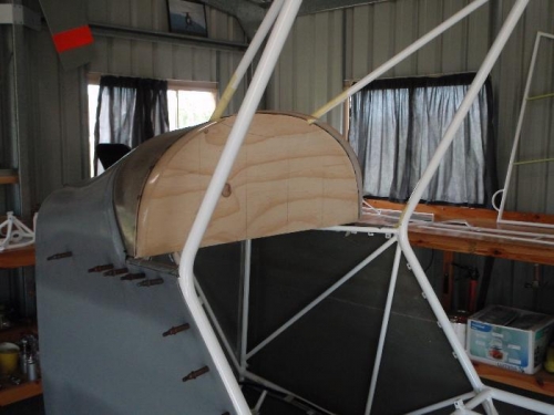

Fit modified fibreglass glaresheildand drill off to attach to boot cowl,Cardboard panel template made.Then the timber mock up panel cut out and fitted to structure..Note: extra room behind panel area and also more vertical stance of panel.Still more work to do ,sub panel and attachment for panel to be installed on the fibre glass glaresheild prior to cutting replacment aluminium panel
Cardboard pattern for timber mock up panel
side view of modified glaresheild and plywood panel in place
Plywoodpanel cut to shape
