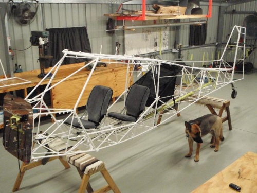

Main under carriage
Prepare sockets and landing gear rods,install rods and set up in taxi position,align all components and drill 3/16" pilot hole thru complete assembly.remove legs and drill and ream to final size.Reinstall in A/C
Note: This is only a dummy bolt shown
Final set up....
progress shot
