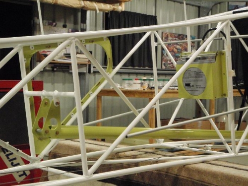

Brief Description:  Battery box,access panel,controls,
Fit up all components of battery box and access panel,trial fit and trim,drill off all components.remove all parts and debur ,prime with 30-Y-94 primer and install anchor nuts and rivet all assemblies together.Install on A/C.Build up control jackshaft,get assembly running true,minimum friction,install all bushing and assemble into A/C,assembly universal joint and fit 2nd aft control rod,install all control bolts and saftey.Install rudder cable, pulleys and drill and fit fair leads
Battery box installed,access panel installed

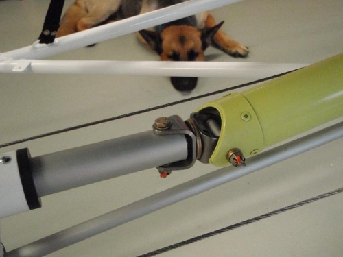

control jackshaft to aft control rod junction...ummm and Storm the sleepy dog !!!

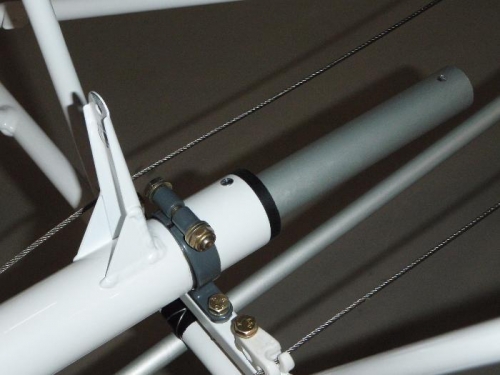

jackshaft with inner control rod fitted rudder cables and fair leads
