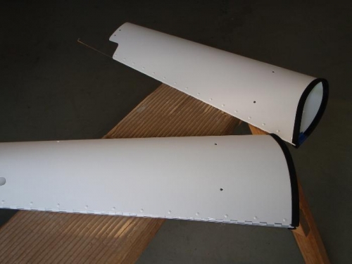

Glue rubber section to leg fairings,jack aircraft (See my entry 05/07/2010...Jack pads....worked a treat great addition) and remove wheels.Install leg fairings and hardware,reinstall both wheels and set wheel bearings as per Matco instructions,saftey both wheel retaining nuts.Install all South Co fasteners in top and bottom cowls.give firewall fwd a final inspections for tightness and security of all pipes wiring and hardware.Fit both engine cowls and secure all fasteners.
Leg fairings ready to fit

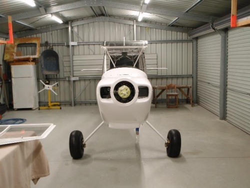

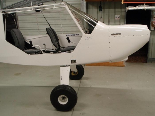

fairings,wheels and cowls final fit
front view
front view
