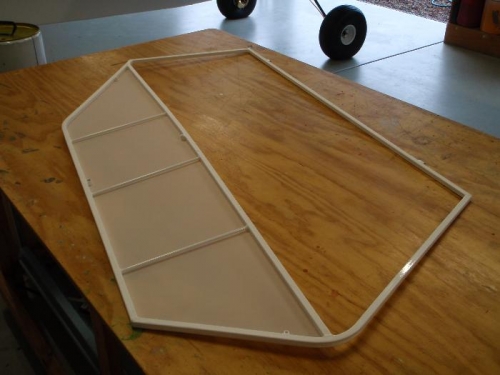

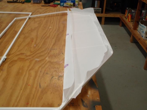

Fabric cabin doors
Prepare both cabin doors and install fabric to the two frames,smooth over the entire items and coat both doors with Poly Brush.Edge taping to both doors completed.Burn all bolt holes and openings for drains.
Covering process
Second peice of fabric going on
Fabric complete and Poly Brushed ready for taping
