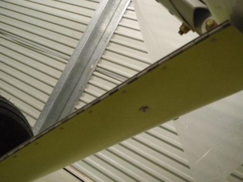

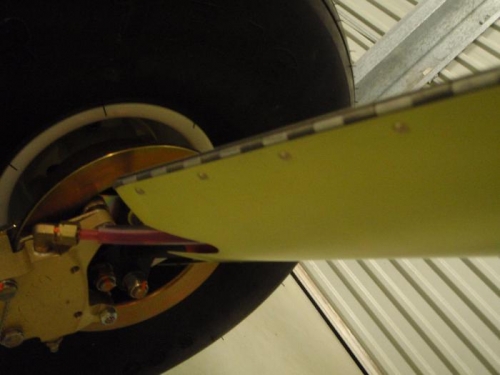

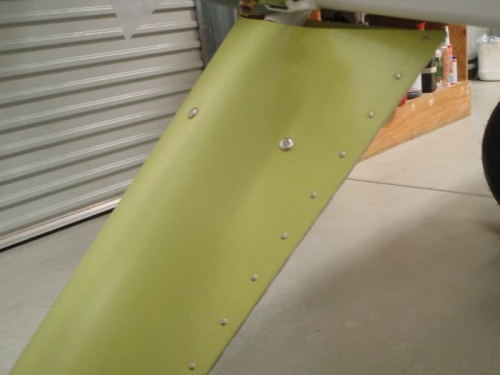

Brief Description:  Modify gear leg fairings
Modified gear leg fairing by installing a hinge down the rear edge of the leg fairing and installing anchor nuts on the mid leg support .This allows removal of the leg fairing by removing 6 screws and pulling the hinge pin out thus allowing inspection and any maintenance on the leg ect..
Modified leg fairing #1
Modified leg fairing #2
Modified leg fairing #3
