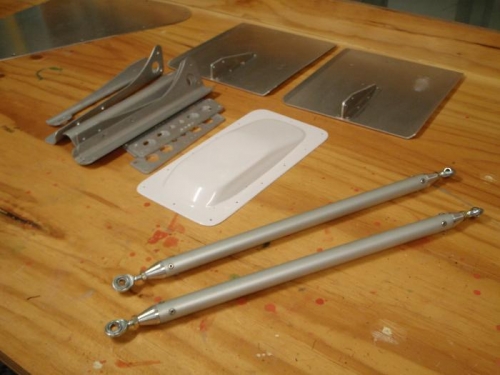

Brief Description:  Miscillaneous jobs/Gap seals,fuel drain,paint

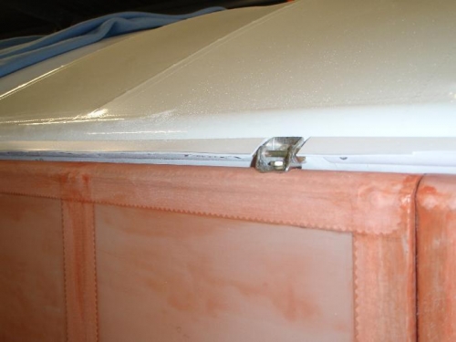

Installation of aileron/flap gaps seals.Unfortunately the seal material supplied with the kit has a different dimensional cross section than that of the rear spar/smaller/and when rivetted into position puts a slight wave along the back edge of the seal.Anyway once the controls are in place wont be visible,pity Rans didnt address this $#@Manufacture flex hose and installed it between the gascolator and remote fuel drain tap I mounted just aft of the engine radiator.Manufacture 2 aileron control rods and build up aileron spades,used AN470 -4 solid rivets to rivet the spade and attach bracket together vs pop rivets.Trim trim motor fairing.
Aileron/Flap gap seals
Fuel drain gascolator to drain tap
Aileron control rods rods,spades
