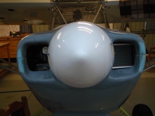

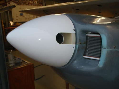

Front end of cowl reworked
Front view
Front view

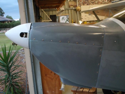

Completed job fasteners installed temporarily until painted
