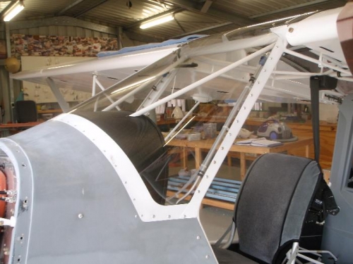

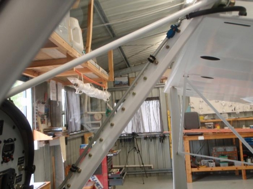

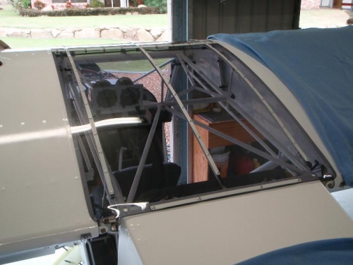

Brief Description:  Install windscreen and skylight
Install windsreen ,substituted rivets with AN525 screws to retain side plates,Sikaflex used to secure and seal screen and retainer strips.Skylight fitted ,substituted Acrylic perspex in place of the Lexan.I installed 8/32" rivnuts in skylight support tubes and fastened the skylight with AN525 screws,the perspex was layed down over a thin foam strip.Sikaflex used on screw threads as a locking feature into the rivnuts.
Finished product
Finished product
Side plates and plumbing
Done deal....
Done deal....
