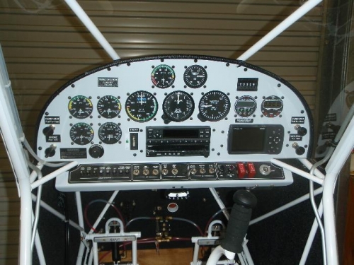

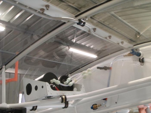

Brief Description:  Tidy up jobs..../dash,glaresheild,plumbing

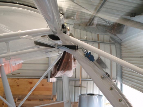

Cover glaresheild with vinyl,install plastic edge strip along aft edge of glaresheild.Make mounting bracket and install slip gauge below dash switching panel.Instal brow light strip under lower side of glaresheild.Complete pitot static plumbing and terminate at front dash instruments.Make up ends for fwd fuel lines and assemble plumbing,install Adel clips to secure lines windscreen retainer plates
Completed dash/glaresheild/coaming
Completed pitot static plumbing runs
Pitot static and fuel line installation
