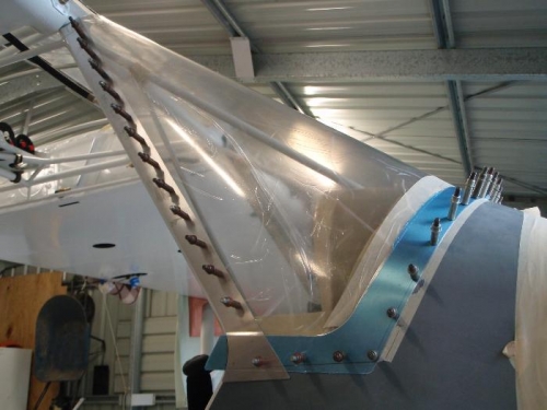

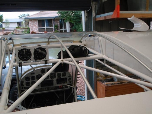

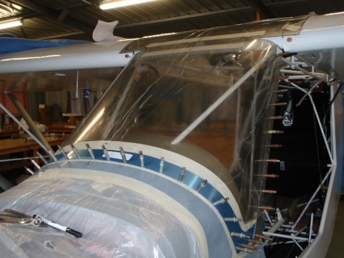

Skylight support tubes installed , rivet holes in fuselage support tubes didnt line up all together well,ended up installing rivnuts in aluminium tubes and screwing these three tubes in place ,this overcome the 3/32" holes that didnt line up.Acrylic screen cut and trimmed to suit boot cowl,,retaining strips drilled off and side Z section retainers installed.Windscreen basically fit need to do final trimming and clean up as well as open up all attach holes.Jeff and Becky at Aircraft Plastics need a pat on the back as this was a nice fitting windscreen and didnt take a lot of trimming .
Skylight support tubes in place
Windscreen trimmed and pinned in position
Screen ready for final trimming and clean up
