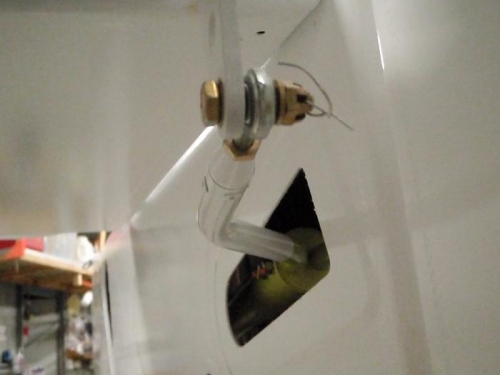

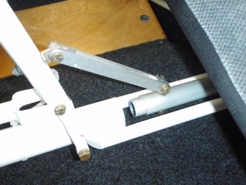

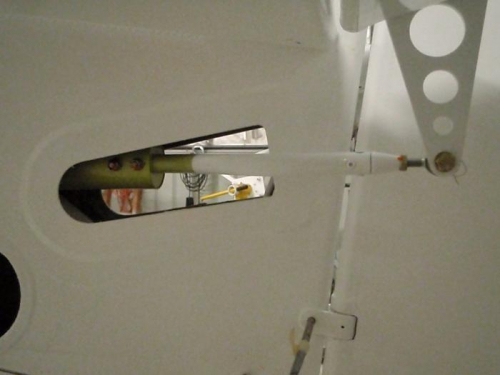

As per my log entry on the 22/8/09 the R/H arm on the elevator yoke was approx 10 mm inboard of the elevator attach horn.Pattern made up and I was able to put the yoke rod back in a 5/8" bender and offset the bend approx another 10 mm outboard to align with the horn.This worked real good however in off setting the bend it made this leg of the yoke approx 1/8" shorter,I was able to account for this with the rod ends ,but in setting up the the up elevator 20 degree travel I had to increase the length of the control stop by approx 3/16".Rigging complete on the elevator control system ,just needs ballancing of the control surfaces prior to safteying the system.
All in the correct place now

system  all bolted up
lengthened control stop
