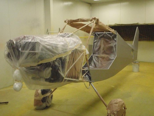

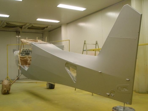

Sand down all fuselage and tape edges,iron curled pinked edges,prepare and wash floor of spray booth,wash down fuselage with wax and grease remover,tac rag entire job,application of final Poly Spray coat,now ready for final inspection and top coat of Aerothane....Shew big job.....stay tuned...........Now to let it sit for a couple of days to cure....
Poly Spray all complete
Nice product,nice finish
Cure then Aerothane...
