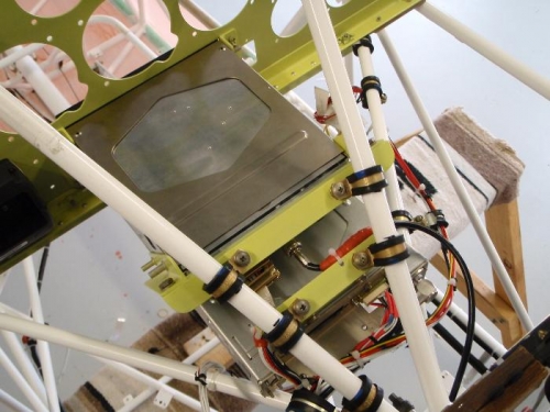

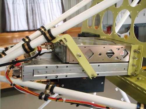

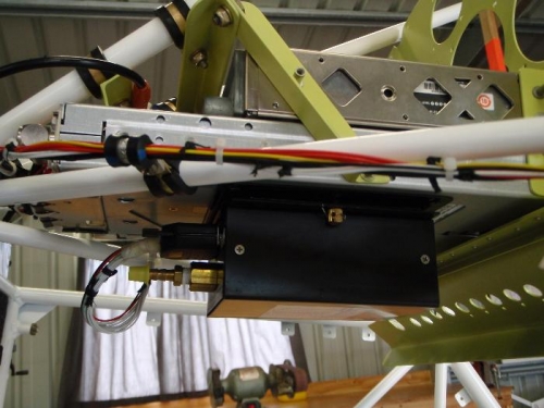

Brief Description:  Radio rack/harnesses
Install dash assy and manufacture radio racks for Txpdr,VHF and Encoder.Rack made from 3/4" x 3/4" 2024T3 angle and held in place with a combination of Adel clips to airframe,rivets and associated other hardware.All bracketry primed prior to installation.Encoder attached to lower side of VHF radio rack.Install all radio harnesses and associated antenna runs
manufactured and installed radio rack
top view of installation and wiring harness
encoder mounted to VHF radio rack
