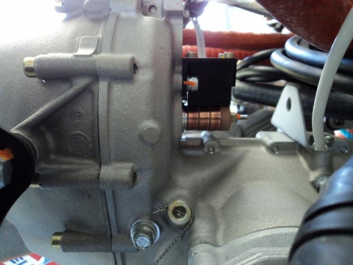

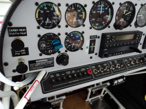

Today we finally put the pointy end on the plane.....The Airmaster AP332 is a superbly supplied kit.The hub is machined aluminium incorporating 3 tapered and L/E caped Warp drive blades.RPM control is sensed by a mini slip ring assembly that bolts onto the rear side of the accessory gearbox,this signal and the controlling of pitch settings is all fed into a dash mounted control head and manual over ride s/w yet to be mounted next to the throttle.All the documentation and ease of assembly was first class.See next log for more pics.

Mini slip ring assembly
Propeller controller
