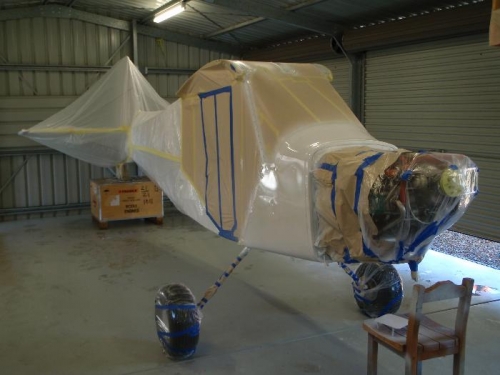

Prepare shop for painting and wipe down all parts with wax and grease remover,tack cloth everything and apply primer to fuselage and touch up rivet lines on doors.Cut and install rubber channel section to the gear leg fairings.

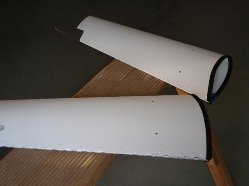

boot cowl all primmed

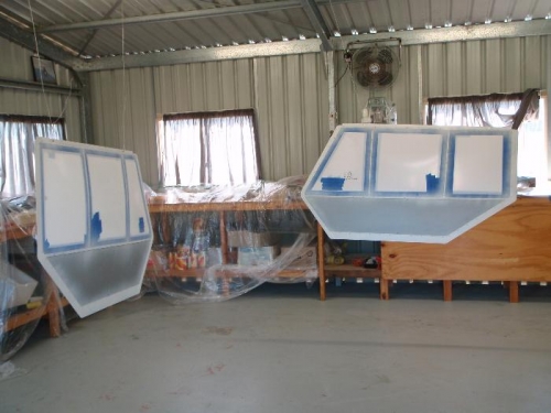

doors primmed over rivet lines ect....
