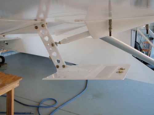

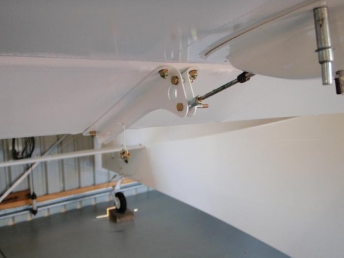

Build up ailerons and spade assemblies,build up flaps and flap machanism brackets..

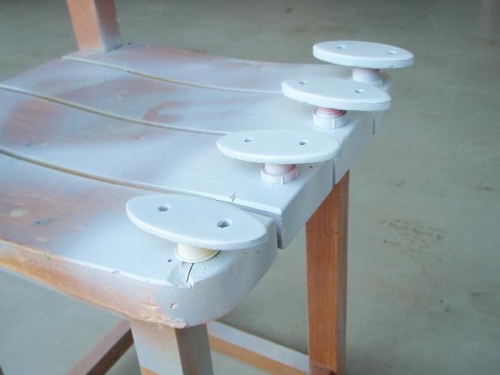

Manufacture four lead weights for control static ballance....what did I use for this shape??????Youll never guess ..a egg ring for frying eggs,and then I squashed it into an eliptical shape...worked a treat...Now wait to see my bacon and eggs #@!@##!@!

Ailerons and spade trial fit up
Flaps trial fit up
Flaps trial fit up
Lead weights for elevator and ailerons
