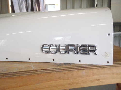

Another busy day,aquired some name badges and afixed them to the top engine cowl..".Courier"
Had the compliance plate engraved and drilled it off ,Ill finally attach it once I have the weight and ballance details

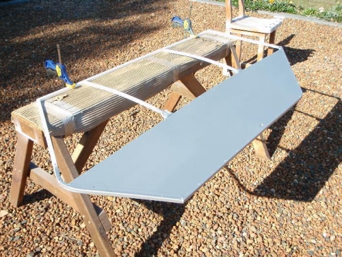

Gave both cabin doors a couple of coats of Poly Spray,I intend to now build the doors up and once all rivetted together I'll paint the entire door white.
Installed the engine cowls and trialled all the fasteners,I made a couple of small clips mto attach the lower rear edge of the cowl to,I'll post it next log.Remove propeller,I've decided to install a "Airmaster constant speed unit".My Sensenich composite blades can be fitted to their hub.Pack blades and spinner and send off to New Zealand for assembly.Looking forward to this adition now I've taken the plunge...
She's got a name now.....

Doors getting the Poly Spray treatment.
