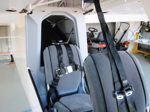

Installed seat belts,made a stainless steel doubler plate to back up the park brake valve,this gos on the fwd side of the firewall and stops the twisting of the valve and firewall when depressing the brakes,without it eventually I think the thin firewall may crack out.Gave both doors 3 coats of Poly Brush,and primed all the metal door trimmings.

Seat belts and harnesses
