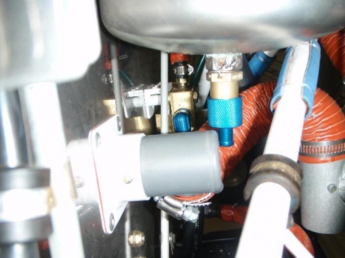

Install quick release oil drain fitting in oil tank,this involved manufacturing a modified aluminium elbow to re route the hot air scat at 90* to the firewall and out of the way of the newly installed drain fitting

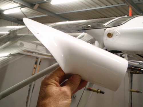

Cut and fit both cuff fairings,set out and fit intersection fairings between wing and fuselage.I installed 8/32" rivnuts to attach the intersection fairing to lower wing.

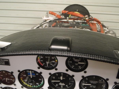

Drill coaming and install remote GPS antenna.
Quik release drain valve and modified heated ducting
Cuff and wing/fuselage gap fairings fitted
Remote GPS antenna
Remote GPS antenna
