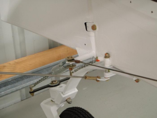

Set the rudder stops to 30* + - 3*

Set rudder stops
Set rudder stops
