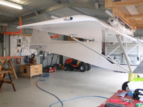

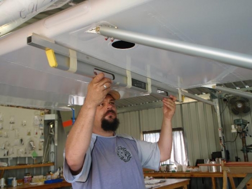

Brief Description:  Set wing wash out
A/C set up and levelled,laterally and secondly fore and aft with the use of levelling bar called out in construction manual.levelling bar moved out board of wing struts once in board level set,additional shim added to rear end of levelling bar and wash out adjusted to reset level at this mid way point.Strut rod ends locked up,washout set....
A/C levelling
A/C levelling
Fore and aft level set with levelling aid
checking and setting washout
