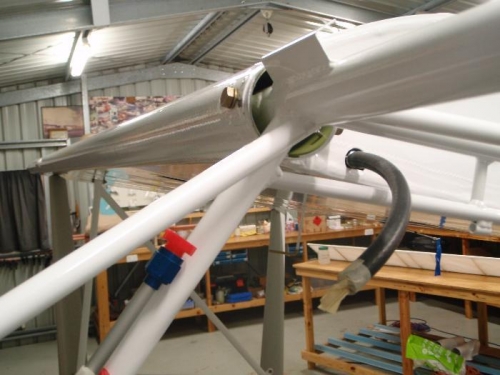

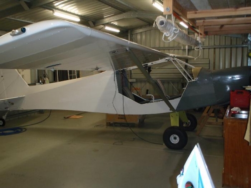

Wings offered to fuselage,rear spar attach bolted up and fwd wing strut installed.3/16" drill guide pressed thru fwd side of wing spar into T bone.Initial hole drilled...drilling bush now swapped for 1/4" guide and drilled,wing removed and rear side of spar hole step drilled and reamed to 3/8,Holes deburred and wing reinstalled.Other wing ditto,ditto....Rear wing strut installed on both wings,triangular strut braces installed.

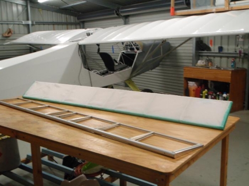

Flap frames anti chaffe tape installed and anchor nuts installed,one flap assy covered in fabric,ready for preshrink.

Drilling of fwd spars
Wing flaps underway
Wing flaps underway
Done deal..bolts drilled and reamed,Strut braces installed
