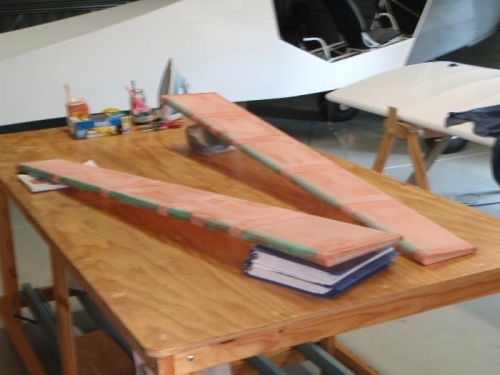

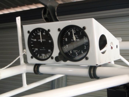

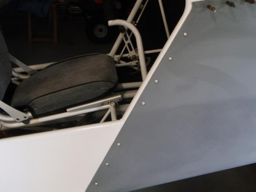

Installation of rear altimeter....Install side screws to attach boot cowl to frame...Ailerons,smooth and final shrink carried out,apply first brush coat of Poly Brush,make out ailerons for tapes and start installing chord wise direction tapes and gussets
Rear instrument cluster complete
Boot cowl attach hardware
Ailerons well under way...great doing small fabric jobs for a change after wings and fuselage
