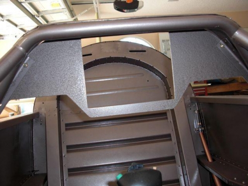

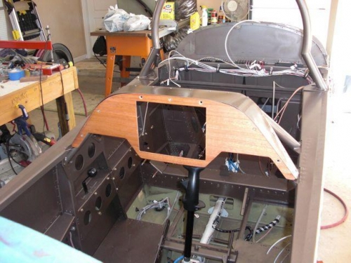

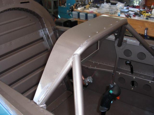

Brief Description:  copilot panel
fabricated a panel for the copilot to use a skyview 7" display. First constructed a shroud over the rollbar then measured and trimmed panel material with a cutout to fit the Skyview. Used pop rivets to hold in place on the roll bar. Will need to fab support braces later on once the panel is installed.
