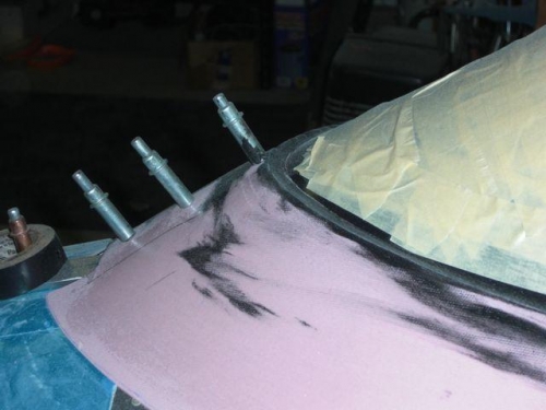

Brief Description:  Skirts
Glued both skirts into place. The Todds canopy is a different shape than the stock VANs so the skirts do not fit at the rear at the same angle as the stock. The choice was to cut the aft half of the skirts off and make new ones or create an intention step at the rear to accomodate the angle change. I'll make the step and see how I like it. If I don't, I can cut them off and make new ones later on.
notice the step!
notice the step!
