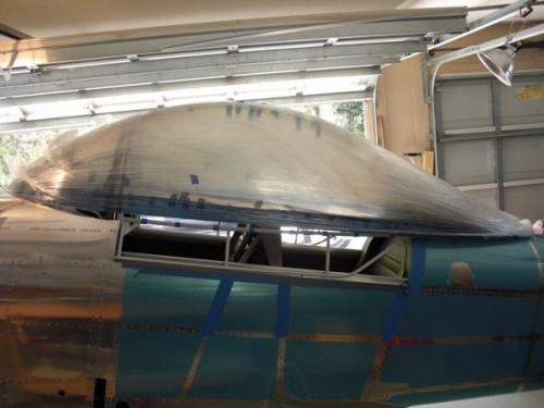

began trimming the canopy to fit the fwd fuse and canopy frame. Fit laid rough canopy onto windscreen and frame and adjusted to achieve the best fit. Using a dremel tool and cutoff wheel began trimming to fit. Used a 1/2 in block of wood and a sharpie to trace the fwd section onto the canopy as a trim pattern.
