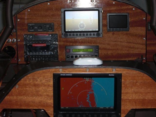

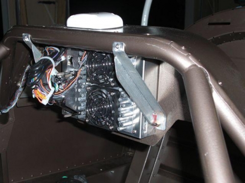

installed rear SkyView display and fabricated mounting support brackets from 3/4 angle alum. drilled holes for GPS ant and mounted the ant. Routed wiring from fwd cockpit and connected the rear display to the network and power lines.
Powered up the rear display.
