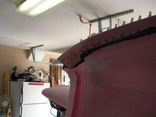

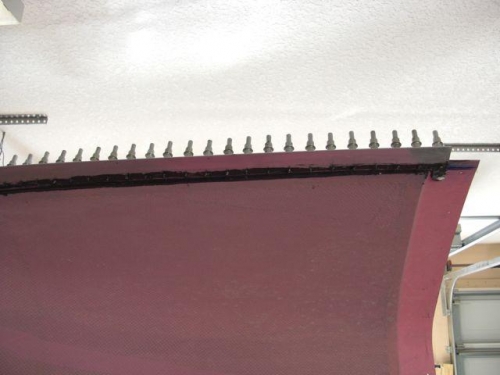

more work on the cowling and skybolt install. Cut the flanges to length, drilled flanges and cowling and cleco'd in place with a bead of proseal for sealing and additional strength. I also started glassing the cowl face so that I can shape to match the spinner.
