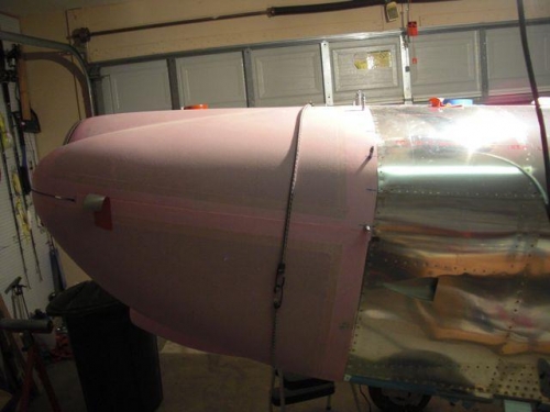

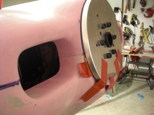

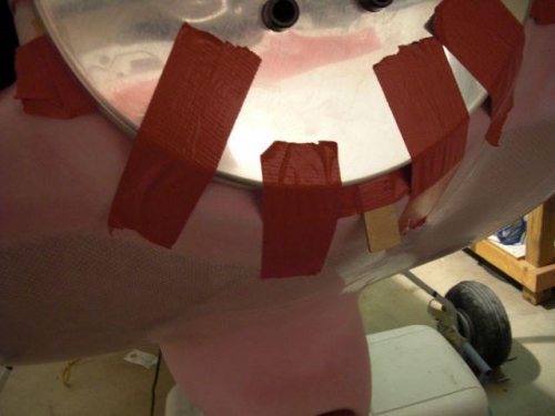

Brief Description:  cowl
continued with cowl fitting and trim. Attached the prop extension and spinner backplate to provide a fwd to aft fitting settup. My plan is to proved about 1/4" spinner to cowl clearance for ease of removal. It is clear the cowl nose will need some work to fit my spinner.
