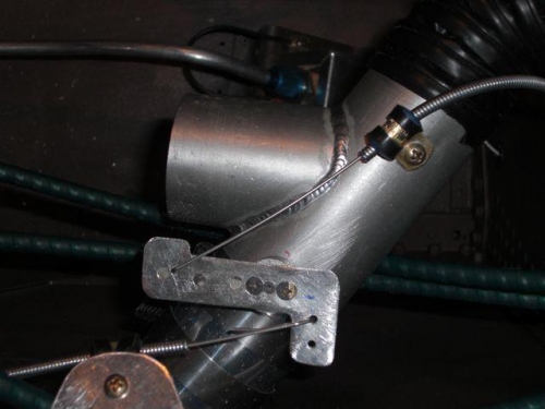

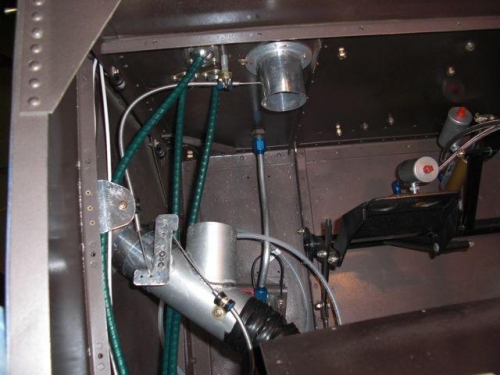

Spent all day today fabricating a heater/cooling mixing valve for cabin air. this takes heat from the heat box and mixes with outside air via a single push pull cable connected in series between the two.
