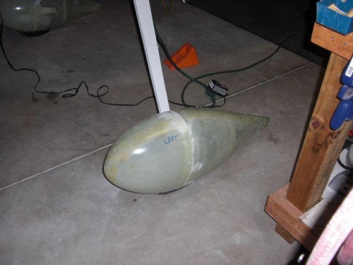

Brief Description:  Landing Gear fairings and Wheel Pants
Trim, fit and installed both landing gear fairings exactly according to plans and instructions. Due to the very tight fit it doesn't appear it will be possible to remove or install these fairings with wheels on the gear due to the sharp bend that would be required of the hinge pin.
Trim, fit, riveted and prep'd both main wheel paints. Installed the brackets, nut plates, drilled all holes and aligned to the fuselage IAW all instructions and drawings
