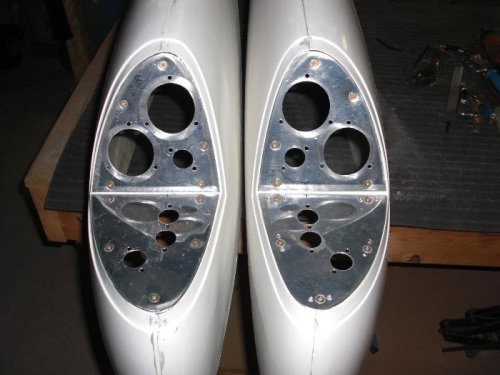

Prepared VANs intergral Taxi/Landing lights IAW instructions.

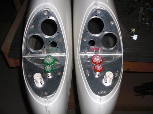

added a 3/4" hole in the T/L mounting plate for the 5W Super Bright LED strobe I'll be using. This strobe will cover the forward section of the plane.
Constructed a mounting plate for the LED Position LIghts and stobe.
Mounting both plates usig nut-plates.
The lateral strobe covers aft 70 degres and all points laterally from the plane.
Total cost of all position and strobe lights with mounts = $147
LDG/TAX/NAV/STROB Plate
LED NAV & STROBE
