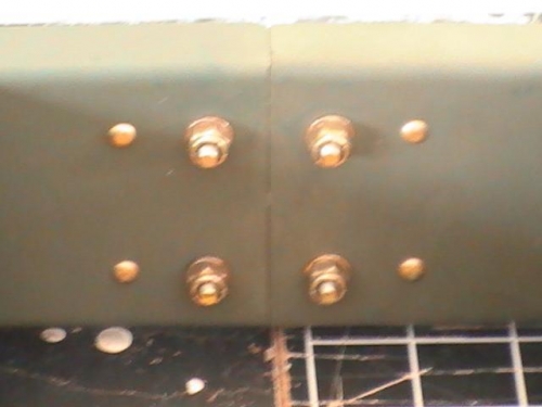

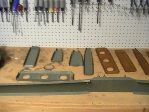

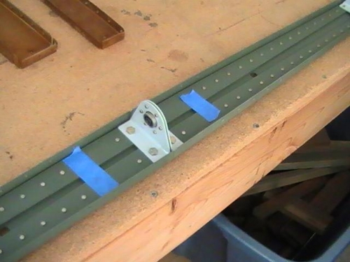

Brief Description:  Preparing HS Ribs & Drilling Horizontal Stab
Completed all steps of HS construction see manual
Drill all rib to spart attach holes
Straightened, deburred, dimpled all HS ribs
Enlarged the HS708 to HS603PP holes to #21
Alligned all flanges of HS404
Drill all HS stab holes to final size
Primed all pieces
Riveted HS IAW instructions.
Repeated all steps for Right side
