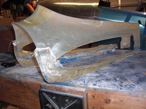

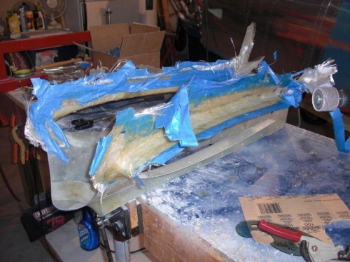

Brief Description:  emp fairing
decided I didn't like the stock fairing. I used modeling clay to form a mold along the lower HS stab fuselage gap and used glass and polyester resin to form the lower fairing half. After this set I rough trimed with a cutoff wheel, file and sand paper.
