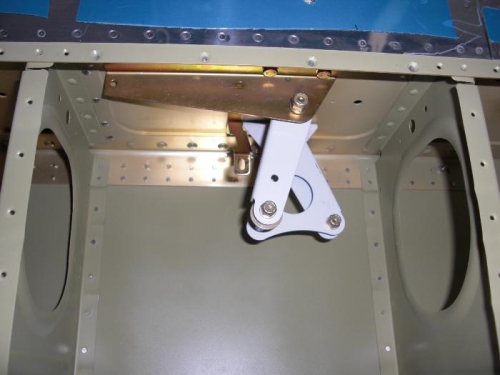

Brief Description:  Wing Control System
Prepared and installed control system components in both wings. Installed Dynon roll servo mounting bracket in right wing and constructed control arms per Dynon instructions. Modified the VANS bellcrank in the right wing. Reamed the bellcrank hole, trimmed the brass bushing to allow only 1/64" excess, installed both bellcranks, and aileron to bellcrank push-rod.
Installed Dynon SV-42 servo in right wing IAW with Dynon instructions.
