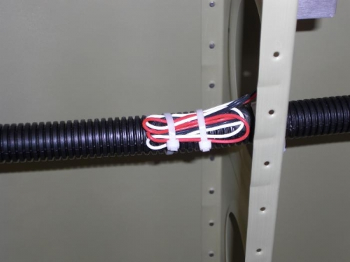

Brief Description:  Left Wing Conduit
routed wiring conduit through left wing and zip tied twice at each rib. Drilled small hole in conduit and placed a grommet in the hole for the dynon heated AOA/Pitot tube controller wires.
soldered 16G colored wire to the dynon controller, heat shrink over solder joint and routed through the conduit to the root of the wing.
