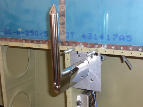

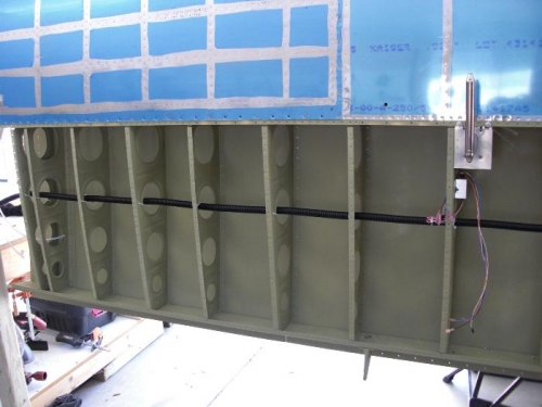

Brief Description:  PITOT TUBE
Fabricated mounting bracket for Pitot Tube Extension mounting bracket and riveted in place along forward portion of the outboard side of the rib outboard of the most outboard access panel.
Mounted Dynon AOA/PITOT tube heat controller in same location. Installed blind nuts on controller to aid in installation and removal for maintenance.
