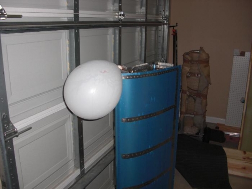

Brief Description:  Pressure Test Of Left Fuel Tank
Pressure tested left fuel cell with balloon attached to vent line. Discovered small leak at baffle up surface. Applied Proseal along entire upper baffle surface. Connected ballon and inflated. Coated tank with soapy water...as of 1800 8 Feb 2009 no leaks indicated. Will let the ballon stay connected to see how long it takes to deflate.
Left Tank Pressure Test
