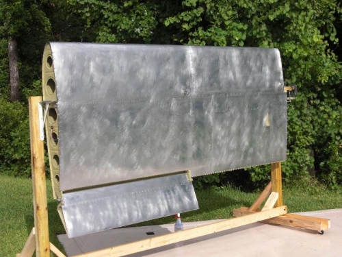

Date:  7-3-2010
Number of Hours:  11.00
Brief Description:  Painting
Prep'd the right wing for painting by first ensuring all screws and bolts were installed correctly and inspected the integrity of the wing and flight controls for proper installation and operation. I then closed all access panels and removed the flaps. I used an industrial strength detergent and scotch brite pads to thorougly clean the wing. Then I used an aced etch to prepare for priming. Once the etch was complete I used Stewart System one part primer (white) and primed the wing and aileron.
